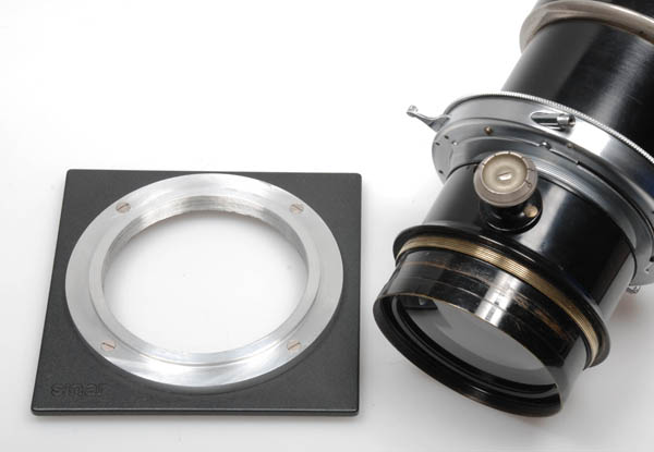

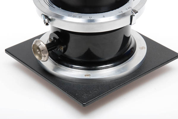

I've just received my lens flange job back from Susie and I'm very impressed.
From start to finish Susie was involved in the finer points of the design - with her knowledge of old lenses and engineering skills she is a fantastic resource!
I needed a flange making for a Wollensak Vitax No.3 which needed to be front mounted to a panel to allow the use of the variable diffusion control. It is a relatively big and heavy lens which needed a sturdy solution. Not only is it a perfect fit (and the control knob is orientated correctly) but it also matches the black paint and nickel plated aesthetic of the 1920's lens. Neat!
Given the other options usually involve shipping parts abroad and (re-importing them) I'd highly recommend Susie's services here in the UK.
Thank you Susie! :D
Problem solved!.jpg (46.9 KiB) Viewed 29959 times
Vitax 3 on Sinar panel.jpg (52.29 KiB) Viewed 29959 times
