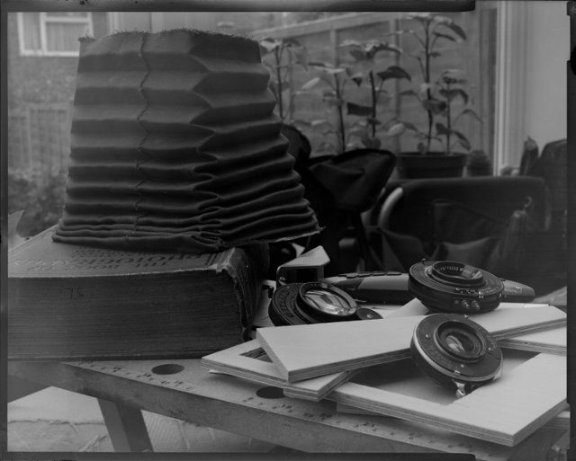

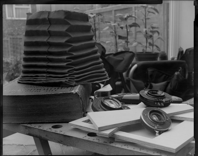

Some scans - ADOX CHS 50 exposed at 25, 50, 100 and developed as above.
The uneven development on the left hand side is what happens when you (er, me) forgets to put the bung back in the bottom of the tank before adding the developer...
- 100ASAsmall.jpeg (51.76 KiB) Viewed 7600 times
- 50ASAsmall.jpeg (43.85 KiB) Viewed 7600 times
- 25ASAsmall.jpeg (46.06 KiB) Viewed 7600 times

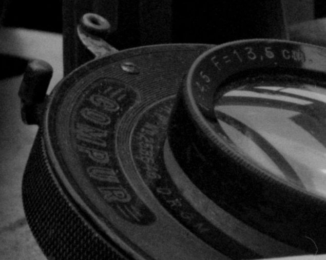

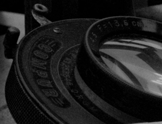

And some full-size clips (scanned at 1200 dpi).
- 100ASAclip.jpeg (52.92 KiB) Viewed 7600 times
- 50ASAclip.jpeg (42.71 KiB) Viewed 7600 times
- 25ASAclip.jpeg (45.94 KiB) Viewed 7600 times
