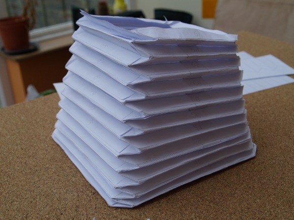

A test that I got the dimensions and geometry right for bellows. It's not as simple as it looks...

Neil,
Looking good. I find the paper mock-up of the bellows is often harder to fold than the cloth ones; I think the stiffeners between the cloth layers really help to 'tell' the folds where to go.
I have had good success with painting the inside of the curtain fabric black and have made a number of bag-bellows with just a single layer of fabric that is painted on the inside; I paint the light-proof coating and have the woven part on the outside for strength but I assume you will put the light-proof coating on the inside of the bellows sandwich; the coating is more delicate than it appears and I always try to remember to cut my fingernails before using the bag bellows
The velcro idea sounds very interesting; I use it for holding on film holders and have also used it as a light-trap material when making film holders. I cut a thin MDF frame for the ends of my bellows and stick the bellows to the frame with contact adhesive. I then have a small rebate on the cameras standard to sit the frame in, often with a felt covering on the mating surfaces to aid light proofing. The bellow frames do add weight though so on the 4x5 I posted previously, the bellows were glued in permanently.

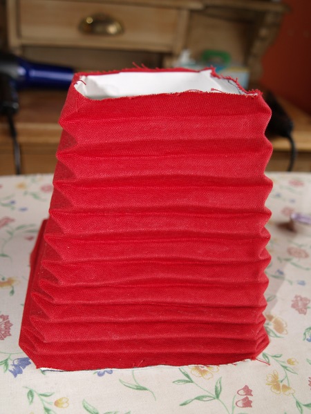

Yes, I have the blackout on the inside, then the paper shapers (my word it's a pain cutting them out - 88 pieces and different shapes), then the outer cover. I have three sides complete on the fabric bellows, with the glue that's holding the final seam currently setting. Then the remaining shapers and the final covers.
I used iron-on 'no stitch hem' stuff to fasten the shapers on - worked really well - and fabric adhesive for the outer skin.

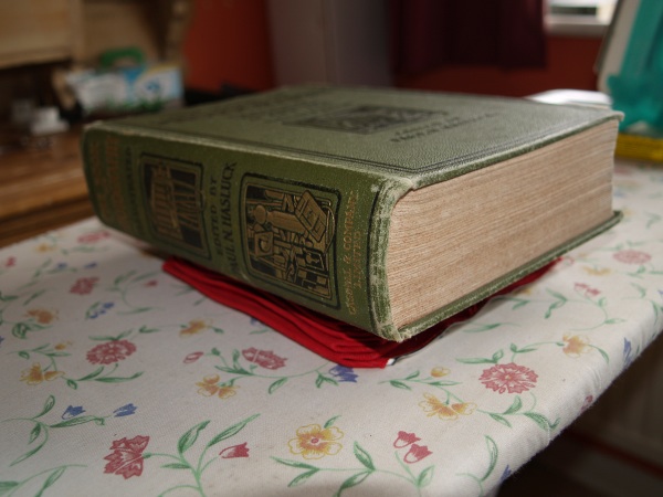

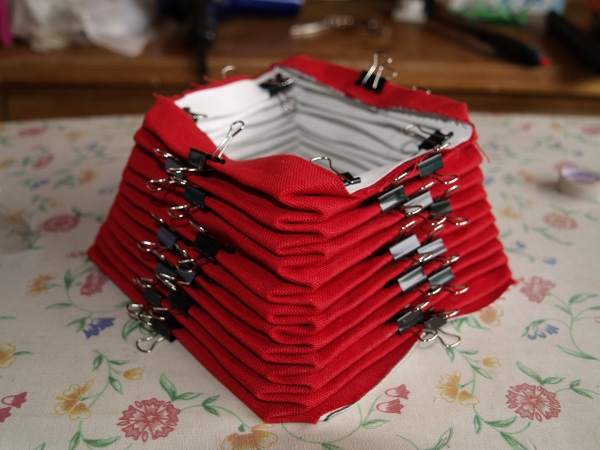

That's the fabric bellows put together. Now I'm happy I can make bellows I can go ahead with the camera itself - though I suspect that future versions may use a commercial bellows; these have come out a bit heavy at 105 grams and it's taken a couple of days to make them.
Tiny bulldog clips are very useful to hold the pleats while folding it, and currently Paul Hasluck's 'Photography' is being, per the title, applied to hold the creases in.

Sweet! I really like the colour.
For the 6cmx9cm camera and also on my 5"x7", I made the bellows out of 2 layers of black craft paper. I figured that if it is raining, the light is not good enough to take photographs in anyway (I often use paper negs of ASA 6) so paper bellows should be viable. As they are reasonably quick to make, if they do develop too many pinholes, then I just make another set. After a month in France and over 100 frames taken, the 6x9 did develop a few small pinholes that I fixed with a dab of black silicone sealant (instant gasket for engines). I reckon I will probably need to make a new set of bellows each year for it, however I am planning to make them a little longer next time to allow better macro shots with some of my longer lenses. My paper 5x7 bellows are 132g (which includes a 3mm MDF frame at the front standard and 6mm thick MDF frame for the rear) and have a maximum working extension of 450mm. In contrast my removable 5x4 cloth bellows weigh 180g and have 3mm thick frames front and back and extend to 350mm. The 6x9 bellows (fitted to the camera in the post above) have 3mm frames, extend to 170mm and weigh 28g.
The bulldog clips are a really good idea; it looks like a trip to the stationary cupboard may be in order!

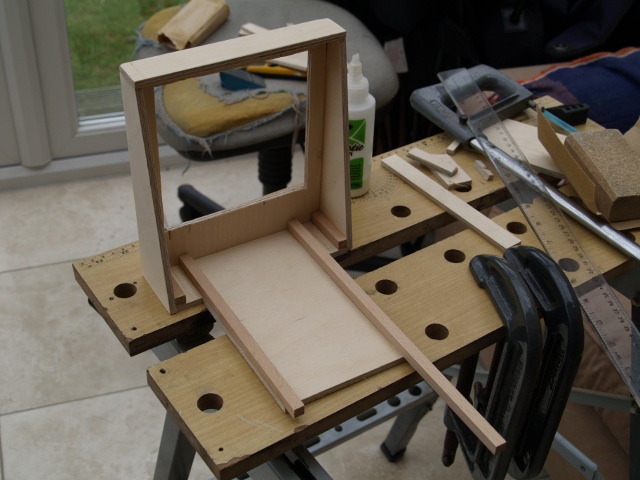

Started building... non-folding, extension to at least 250mm and perhaps 300mm (it depends how stable it is and the length of the bellows when I put it all together).
Tilt, twist, shift in both directions, and reversible back so it will work in both portrait and landscape, rack and pinion focus.

Looks good Neil...looking forward to the rest

It's coming along, but there's a lot of waiting for glue to set. I've done the reversible back which will hold the slides and the focusing screen, apart from how the slides and screen might be held.
Two choices present themselves - either a spring-loaded back which will require the focus screen to be removed before the slide is inserted, or, as on my MPP, a spring-loaded focusing screen which is displaced backwards by the insertion of the slide between it and the body of the camera. Still thinking about that.
I've also ordered a bellows from Camera Bellows - not cheap as a one-off but probably worth it. Put it this way - this is not going to be a four or five thousand euro camera!
