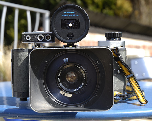

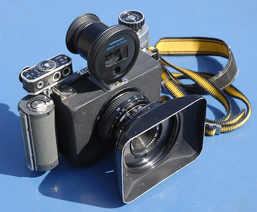

Steve, it's the Olympus mount that causes the vignette when the lens is rotated out.
I found I had to file it to accommodate the image corners.
There isn't a lot to remove by thinning out-
Yes, the rear element only just fits-
I reckon there's only 1mm clearance, so centering the lens becomes important-

Joseph, seriously, how is the film holder clamped to the back of your camera. I looked at the pictures on the other site, but they don't show this.
alan

Ooh, sounds like a challenge to learn proper skills Alan-
Not having the time or inclination to do that,
and not having access to numeric control, other than my own digits,
I'm afraid I have to design within the limitations of what I can accomplish myself-
I suppose I could farm bits out, but it can get expensive,
and there's usually another way to do things.
Perhaps not the best way, but it gets things done.
The back-
yes, that's a weak link- in one regard, it's less than a positive lock.
On the other hand, it's an advantage-
having literally nothing holding the backs in place is a lightweight solution,
and keeps the form factor to the minimum dimensions possible.
This camera was designed to be hand held,
so just holding the camera keeps the back in place.
That, and friction- the back is rebated by 5mm, and it's a tight fit.
I've used it with the 545 back pictured, a Polaroid 550, Horseman 6x9 and 6x12 roll film backs, and an assortment of 4x5 film holders.
Of these, the newer 4x5's, the Polaroids, and the Horseman 6x9 backs are a perfect fit, and are gripped just enough.
The 6x12 back is slightly larger, and is a tight fit, but works. I don't like using it though,
in case it stresses the camera, and stretches it.
The older 4x5's are slightly smaller, and wobble-
one of them is much too small, and fell out the first time I used it.
A metal tabbed Lisco Regal. So they don't get used anymore-
It isn't a perfect solution, and is open to criticism,
but since I'm the only one using it, it suits me just fine.
the interior rebates are lined with velvet tape around the edges...
I also made a ground glass that mounts like a film holder, for critical composition-
but it kindof defeats the point and shoot idea-

I could have used a graflok style back,
but that would have made the camera much bigger,
and much less of a point and shoot.
The next one will have a proper back, along the lines of this one, but smaller-
http://photographyireland.net/viewtopic.php?t=25732

So far, I have only tried this with a 6x6 format so obviously I have missed out on the vignetting. I am hoping that with 6x12 format it will be o.k. too but I'm not sure yet.jb7 wrote:Steve, it's the Olympus mount that causes the vignette when the lens is rotated out.
I can see from your pictures that you have filed out the corners of your lens plate but did you have to file away any of the Olympus part as well?
If I make a 5x4 version to take the same lens mount then I may have to do some filing.

Joseph,
Thanks for your comprehensive reply. I wondered if you were just holding the back in place by hand. My 5 x 4 box camera, which is intended for tripod use, has a back that is rebated on three sides to almost the full depth of the film holder. Two strips of wood, at top and bottom, mounted on bolts that stick out, overlap the rebate. The film holder slides in behind them from the open right side, and is locked in place by tightening knobs down on the wood strips. Very simple and easy to make. For first composing the picture I have a sheet of ground glass mounted in a wooden frame that has the same external dimensions as a film holder. So it slides in first, and is replaced by the film holder when I am ready to take the picture. I fully appreciate that you are using your camera in a different way.
About the dovetails. Judging by the very nice wood shaping on your camera, I think you are being too modest...

Thanks Alan-
Yes, if I was to use only sheet film it could be sorted relatively easily-
but the backs I mentioned are four different thicknesses-
It works ok as it is, better than I might have expected really...
I think this one is probably finished now,
time to move on to the next one...

Thanks Dave. Hopefully I'll get some more pictures up there over the weekend. The old Mamiya Press backs only have pressure plate to match their format, so 6x7 or 6x9 therefore you need to make one. It isn't that hard. I used aluminium sheet from a model shop, made by KS. Replacing the old one isn't too hard, it's a fairly simple mechanism they use. It ought to be anodised black but the backing paper on 120 film prevents any reflection problems so there's no need to worry. You can start heating buckets of acid in your shed if you like to do your own anodizing, people do, it's a fairly straight forward process... apparently! Something like that Screwfix thingy would probably work but the thread does need to be suitable, not to coarse or loose. Pentax made an adjustable extension tube for their 6x7 which may have its uses but I have never seen one... it might vignette. I agree these projects ought to be cheap wherever possible. Part of the joy, apart from actually making something like this, is making it for as little as possible. I already had a helical. The finder is a little grand but I found it cheap here in Hong Kong and MXV happened to have a used 65mm mask for it amazingly. The lens was of a trashed camera I found at a country auction... GBP 20 for a box full of bits including the back. The accessory shoes, strap lugs etc all came from the same cameras. The rangefinder cost GBP 8 from a bric a brac shop. The box is simply plywood. The hood is attached to an old Cokin filter ring and just pushes on... this still needs work. Unfortunately the lens filter thread has a ding in it so can't be used.
Steve... there aren't any pictures of the camera on my site but I'll try to attach some here. Since these were taken I made some alterations, the helical is now on an aluminium plate screwed to the box. I forgot to say before that aluminium tape is extremely useful stuff for light proofing and I resorted to this to get the camera running so it isn't pretty but it works. It's dark here at the moment so I'm a bit stuck for taking new pictures. There should also be a pic of the 4x10 I made. You may notice some common parts! The handles on the front are drawer handles from BQ that just happened to be exactly the right colour. I made the dark slides for this too which was ... well... interesting.
- El Cid 1.jpg (98.25 KiB) Viewed 22544 times
- 4x10 Front.jpg (163.73 KiB) Viewed 22544 times
- El Cid 2.jpg (119.93 KiB) Viewed 22544 times
