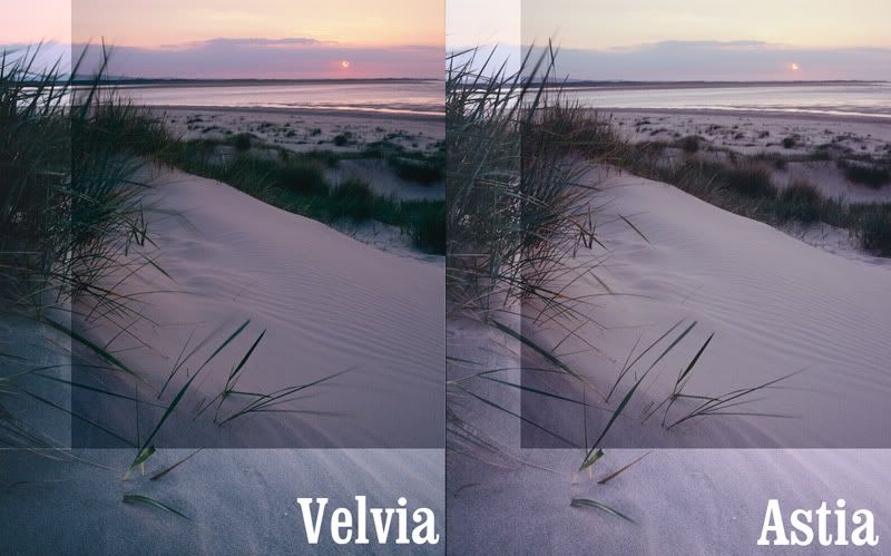

Before you do, I took a lot of comparisons between velvia, provia and astia in Northumberland and will be posting a blog entry about it next weekend - here is a sneak preview.. I don't think I'll be buying another batch as I can get better results (or at least more appropriate colours for the results I want) with Provia... This picture was taken in Budle bay and I've upped the curves on the left and bottom to demonstrate the magenta cast in the shadows to complement the yellow/cyan cast in the highlights

Don't know what you're doing Tim but I don't get such problems. Is this cast on the trannie, or is it only noticeable in the scans?timparkin wrote:This picture was taken in Budle bay and I've upped the curves on the left and bottom to demonstrate the magenta cast in the shadows to complement the yellow/cyan cast in the highlights

Sounds like the pH of the developer. I'm on my way to France to organise a workshop for the Autumn at the minute, I'll dig something out when I get back.timparkin wrote:They are pretty good represenations of the tranny.. I've got the same result on multiple pictures so if it's not the film then it must be Peak Imaging screwing up..
Have you got any a/b comparisons?

I'd be surprised if all of Peak Imaging's results were bad (but not overly surprised). I'll do more tests and send them off to NPS (Joe Cornish's lab) and also to one recommended by you... Who do you think I should use?
Tim
p.s. I've got multiple comparison which all show the same results.. I'd also be slightly surprised if my Astia were developed in different batch than my Velvia being as they all were part of the same set sent off in one go?

Tim - look at the colour of the Fujifilm data in the rebate. I found great inconsistency in this from Peak, from a pale amber to a deep reddish version... Compare the RAP with the RVP and also from previous batches.
As Joanna says, it's all the pH of the colour developer which affects this. I try to get it always the same, varying ±0.03 is fine, approaching ±0.1 and big changes are seen.
Love that shot by the way.
