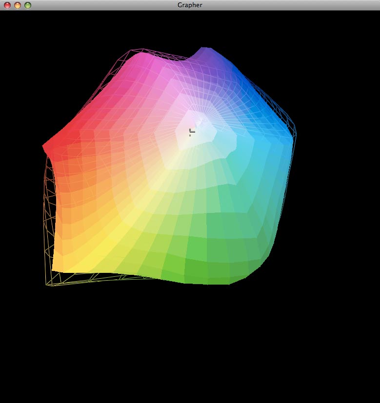

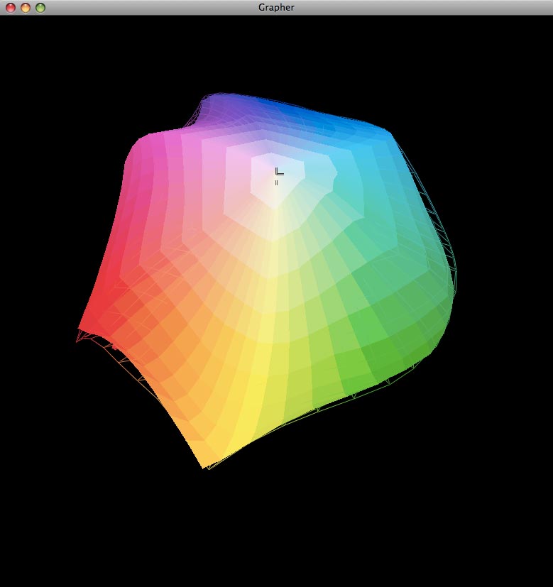

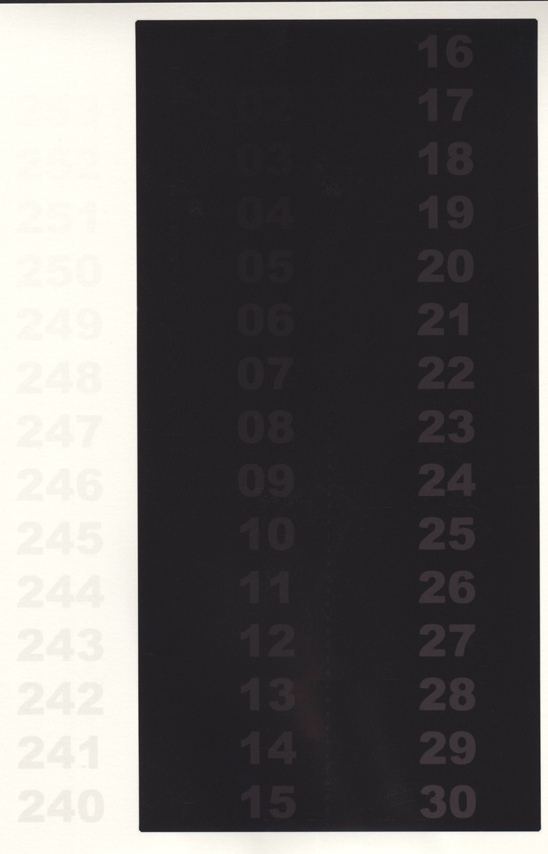

O.K. spent a lot of time on the IPF8100 over the weekend. Here's a post of my results:
First up the Canon was profiled with a BIll Atkinson 1728 patch target on Innova USG285. The media settings chosen in this instance were Pearl 260gsm (innova recommend Heavy Weight Photo 2) 600dpi & a the printers maximum resolution of 2400x1200dpi.
As you can see, the Innova Profile is very slightly larger indicating a marginally bigger colour gamut (MY CANON PROFILES ARE THE SOLID ONES IN BOTH CASES). There's a couple of reasons for this. 1) My media setting & 2) The machine itself. I'm tempted to think its a combination of the 2, & have reproduced a new target on Heavy Weight Photo 2 settings to compare. As you can see however the difference is minimal & with the Pearl 260gsm setting you'll be saving ink/money. I also noticed that my profile lightened the image more than the Innova profile & the resulting prints look excellent whereby the Innova profile would have left prints looking a little dark.
The next grab shows the Canon compared to the 11880. Its pretty much chalk & cheese here. The Epson has a larger gamut in some areas, & the Canon has a larger gamut in others (noticeably blue & yellow).
On the dynamic range test chart, we see the blacks go down to 02 (01 is actually just barely visible) & the whites go up to 253. This matches exactly what I see on my Eizo monitor & gives me option of making adjustments for shadow detail if required. One of the biggest complaints I here about is prints coming out too dark, & here we have the printer demonstrating its ability to render shadow detail as intended.
My next post looks at the Epson 3800 detail vs the Canon
- Quick scan of a dynamic range test chart
- range-tester.jpg (185.82 KiB) Viewed 8529 times
- Canon IPF8100 vs Epson 11880
- ipf8100-vs-11880.jpg (33.9 KiB) Viewed 8529 times
- Canon IPF8100 Ian profile vs Innova Profile
- Ian-vs-Innova.jpg (28.43 KiB) Viewed 8529 times

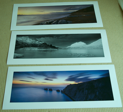

Finally, some 39" wide prints. These were scanned on my Imacon, scaled to 39" wide at 300dpi, sharpened with Photokit output sharpener (inkjet 300 glossy) then printed on Innova USG285.
- Proof of the pudding is in the eating! 39" wide prints
- proof-of-the-pudding.jpg (125.5 KiB) Viewed 8529 times
