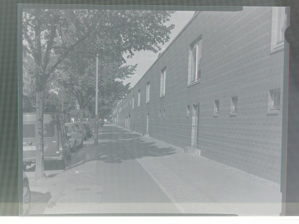

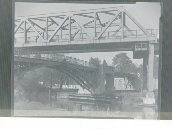

They dried out now; I 'scanned' then by the simple expediency of using the laptop as a light box, shooting them with an Olympus E-400, and inverting the results. The loss of resolution, completely incorrect gamma, vastly reduced dynamic range, and aliasing effects are mere courtesy details. I'll scan and get them on my web site when I'm back in the UK. But they show that something stuck to the emulsion which is a Good Thing[tm].

- Vanishing point with shift
- P4250948.JPG (64.15 KiB) Viewed 7843 times
- Bridges on top of bridges
- P4250944.JPG (61.38 KiB) Viewed 7843 times
