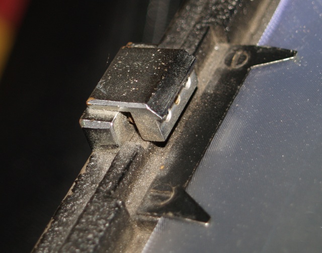

I'm assuming it works the same way as the MPP Press - in which case, it moves out to the edge of the camera. Here's a close up of mine:

The Mark 8 differs from all previous marks in many ways, including the design of this latch.
