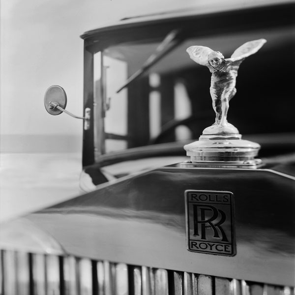

This first shot took me around two and a half hours to set up:
… whereas this next shot took less than five minutes:
It really does depend on what you are photographing, not just your length of experience :D
