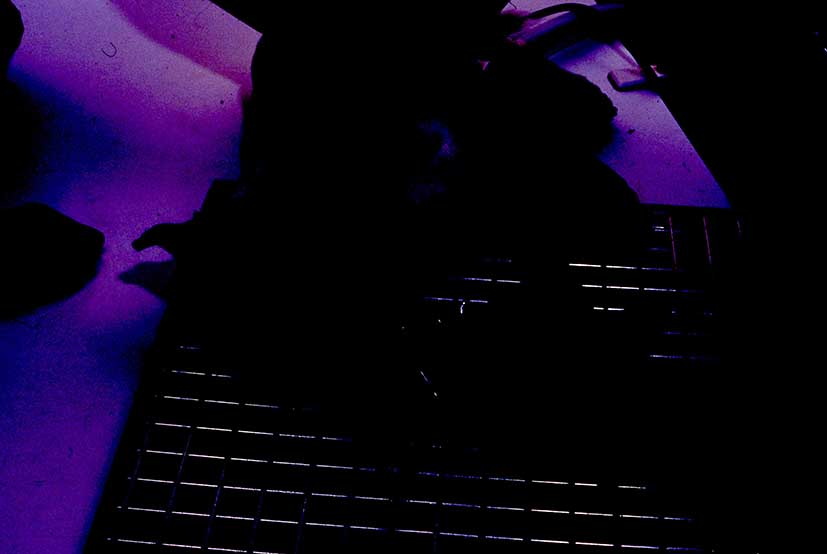

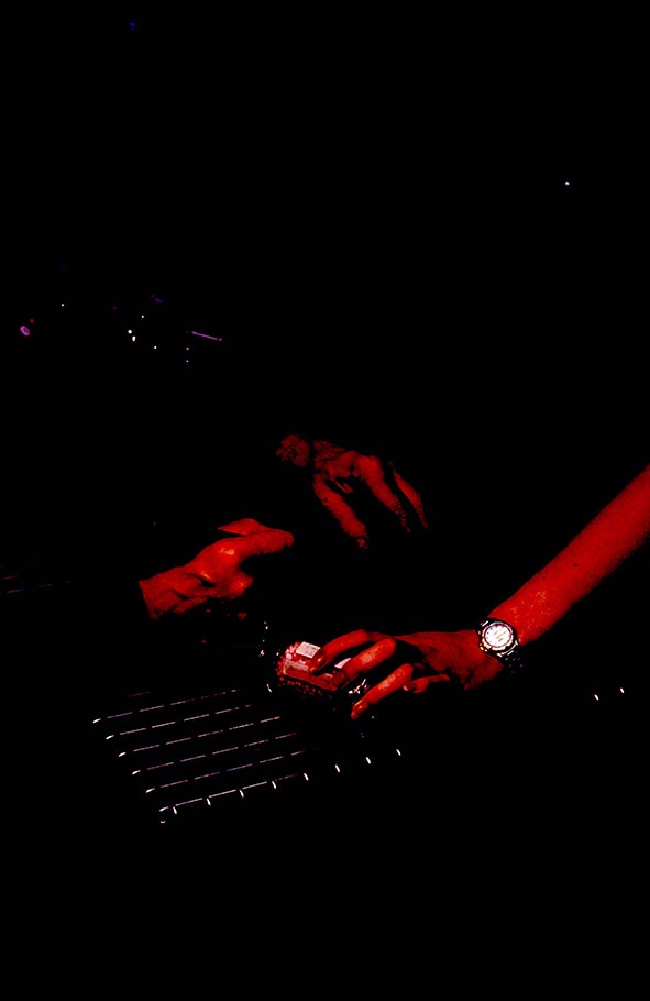

I have a V700 scanner that I am having trouble with. It will be scanning fine and then it will start producing strange colours, noisy and dark images. Then the next time I use it it is working again!! Does anybody know what the problem might be and is it easily fixable?
I have attached some examples shot on transparency many years ago when I was a lad.
Thanks for any advice received.
Chris

Just wanted to send a belated reply to you both. Thanks so much for the advice. I have downloaded Vuescan but the problem still occurred....After quite a few scans. I also checked the calibration area so I guess I can live with it for now.
