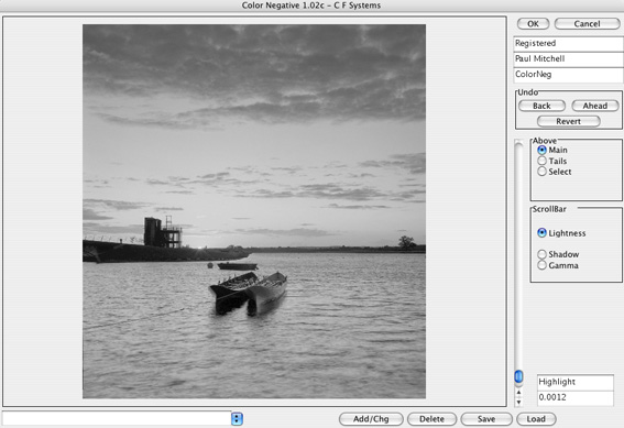

Re: Colorneg with B+W
Which version are you using? I'm still using v.1.02 and this is the window I get
- Colorneg_screenshot.jpg (80.59 KiB) Viewed 4958 times
I'll have a go a reinstalling the B/W bit, I don't get that , thanks for the pic.
